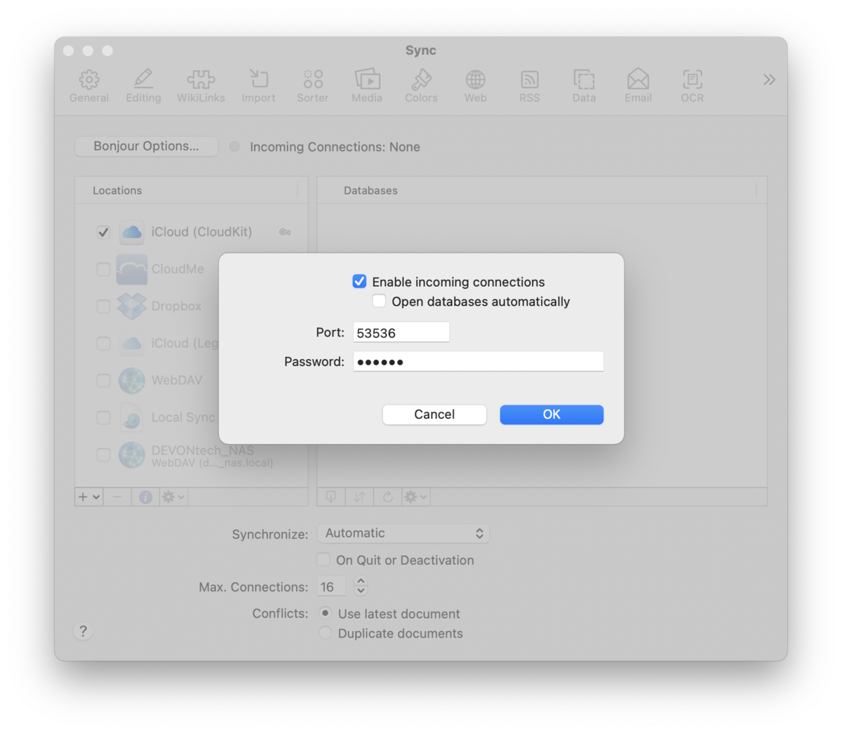

Bonjour (also called a direct connection) is technology you are almost certainly already acquainted with. If you have a wireless printer or scanner and notice how your Macs and mobile devices can see those devices by name with no setup by you, they are using Bonjour. Bonjour is a way for devices, or services like DEVONthink's sync, to broadcast its presence on a network without requiring technical know-how by the user. When it comes to syncing, a Bonjour sync deals directly between devices. One device acts as a server, the other a client to that server. The participating devices must be on, running DEVONthink or DEVONthink To Go, and on the same network. There is no intermediary location where data is stored. This is much faster than uploading all data to some server on the internet and downloading it again on another device. But, when you leave your office and you haven't synchronized your databases, you'll need to wait until you come back another day.
Bonjour Setup:
The Mac with Bonjour enabled should now be visible as a sync location to other devices on your local network. On the other devices, enable it, enter the password, and you can import databases or sync existing databases directly with it.

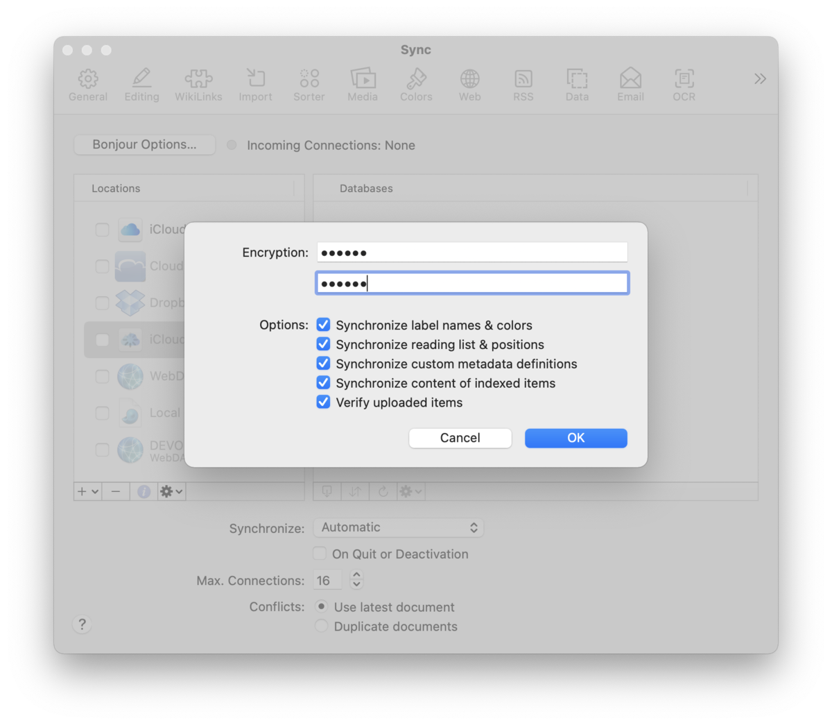

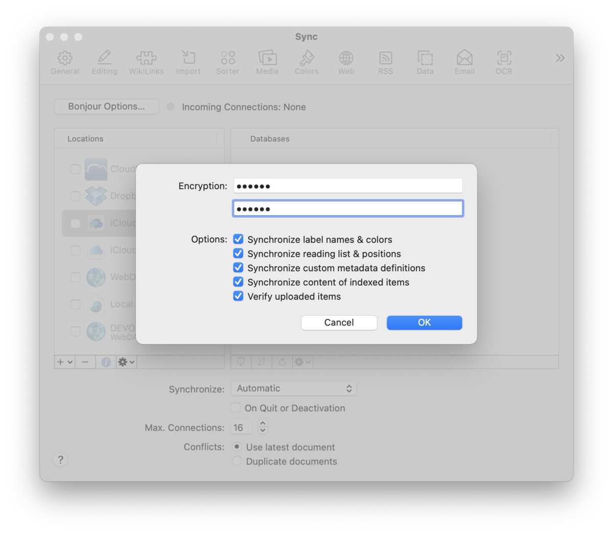

As most Apple devices are logged into your Apple ID, iCloud is the simplest method to set up and sync with. Since it's logged into your personal account, it can only be used for syncing with your own devices. If you want to keep your databases in sync but not share them with others this is a great choice. We strongly recommend an iCloud plan with enough storage. Here are the simple instructions to set it up. iCloud Setup:
One thing to realize with iCloud syncing, the sync is done locally. After sync is finished, iCloud uploads to Apple's servers, then to devices using your Apple ID. This means databases may not be immediately available to sync on the other devices. The initial sync requires patience, as DEVONthink has no control over the speed and reliability of iCloud's process. It syncs to the iCloud folder, iCloud does the rest. See the CloudKit section below for an alternative option. CloudKit (iCloud) Utilizing the same active iCloud account, the CloudKit option offers a single-stage sync with the same simple setup as the iCloud (Legacy) method. However, with this option, the sync is directly to Apple's servers. This can appear to be a bit slower than the legacy option, but once the sync is finished the files are already uploaded without having to wait for iCloud to sync on its own. This also conserves space as no sync data is temporarily stored on the local machine's hard drive. The instructions are essentially the same as setting up iCloud (Legacy). You're just choosing the CloudKit (iCloud) option instead.
CloudKit Setup:

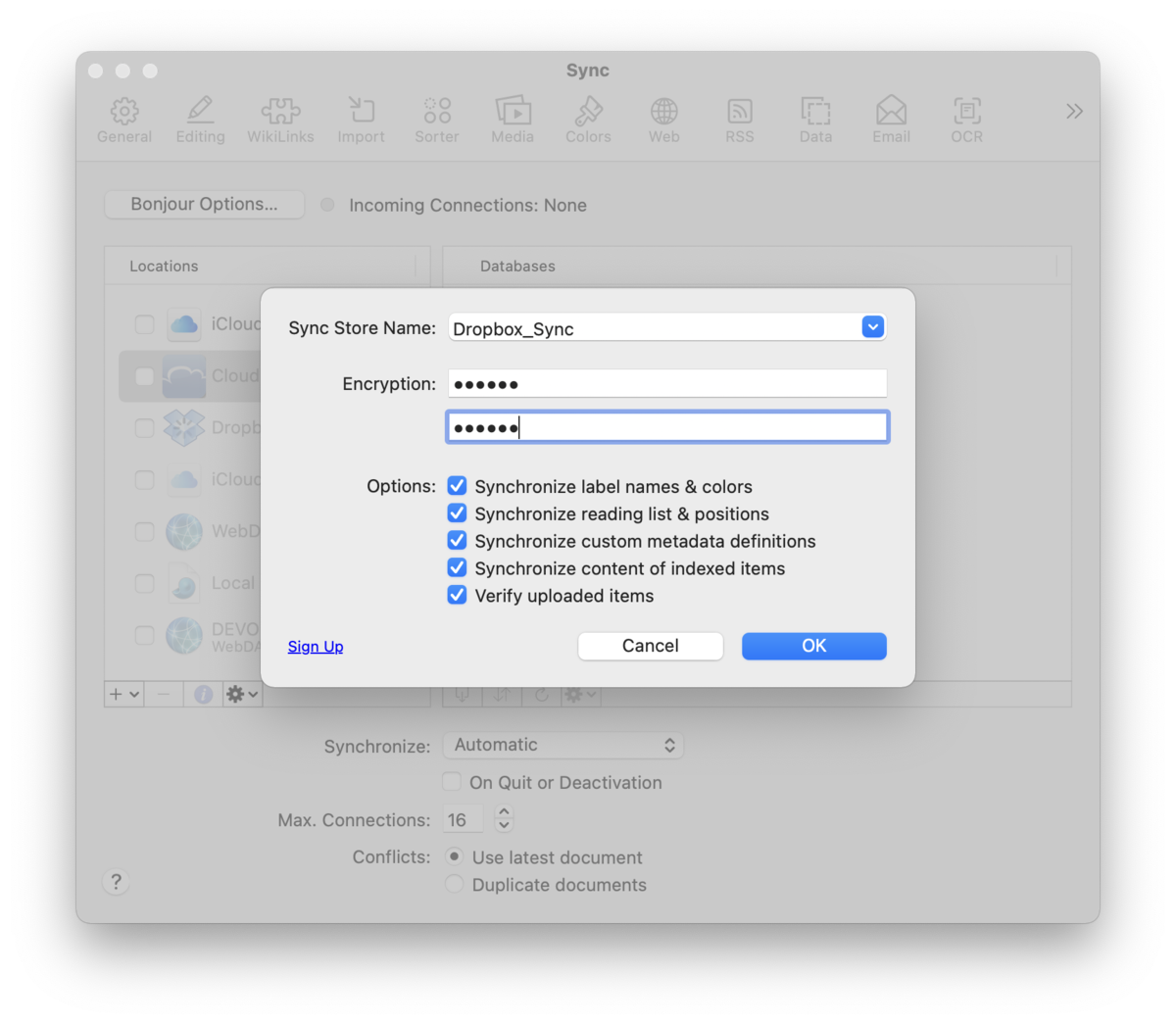

Dropbox
If you have a Dropbox account you can use it just like you'd use WebDAV. DEVONthink creates a private folder for its sync stores and so keeps its data separate from your photos and other documents. Of course it does not get access to anything except its own files. Dropbox and DEVONtechnologies respect your privacy. The setup for a Dropbox sync location is essentially the same as for iCloud. However, there are two differences of which to take note:

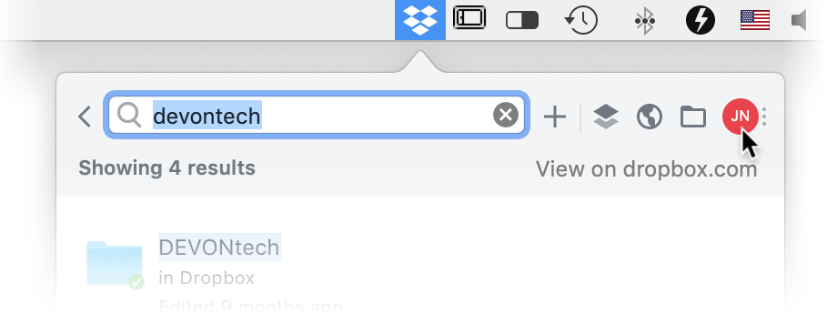

If you are using a Dropbox sync and also the Dropbox application, it is advisable to exclude the

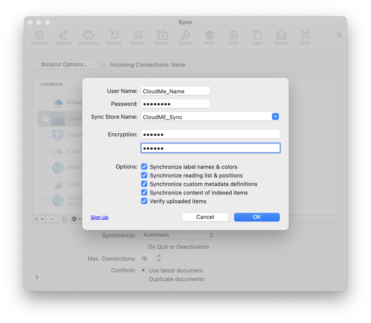

If you run your own WebDAV server, your ISP offers it as a service, or you have subscribed to an online service such as CloudMe, this might be for you. Generally, if you can access the WebDAV server with Go > Connect to Server in the Finder, you should be able to connect DEVONthink to it. Your data is stored in encrypted sync stores on the server. You can keep all your devices in sync at any time as long as you have internet access. Setting up a WebDAV connection follows the same simple pattern and allows you to specify a sync store name. But there are a few parameters that must be entered to make the connection:
CloudMe: A European cloud service offering WebDAV services, there is a built-in template for syncing with it. Just enter the username and password you use to log into the service, enter a store name, and DEVONthink with connect with a proper WebDAV URL for you. Other cloud services: If you are interested in other cloud services to sync with, services offering WebDAV connections should be supported. Check the FAQ or Support pages to see if it's supported. Rolling your own: It is possible to run a WebDAV server on your own. Some NAS drives, e.g., Synology, have WebDAV capabilities and you can run a WebDAV server by repurposing an older Mac. Even some more full-featured packages like OwnCloud or NextCloud can be set up for WebDAV services. However, these options can provide more technical challenges in setup and administration beyond the scope of our support.
